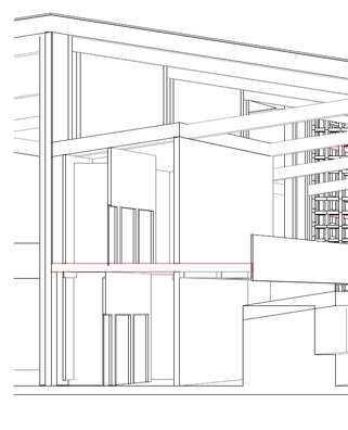

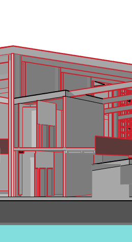

I want to copy lines from a 3D window in vectorial mode with pen settings to a worksheet. However when I paste the lines in a worksheet they appear as black instead of red even with the same penset and override (some lines do appear red).
Am I missing something?
Thanks
