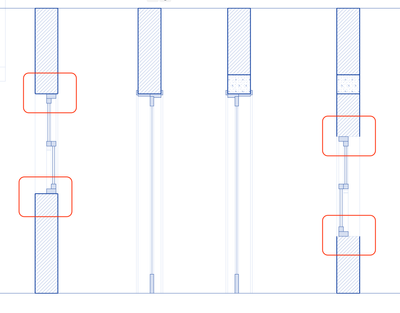

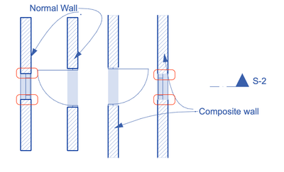

  I was trying to save some time by making a wall composite. But in section and plan, the window and door opening does not show line thickness as seen in normal wall. Am i doing something wrong? how can i make it work line normal section with proper line weight? Thank you.

In the composite settings, there is an option to add end lines to the skins of the wall.
3 REPLIES 3
Solution
Beg your pardon, its a complex profile not composite! is there an option for that?
 Found that! corrected it here! the pen number was 1 here. Thank you for the clue .
