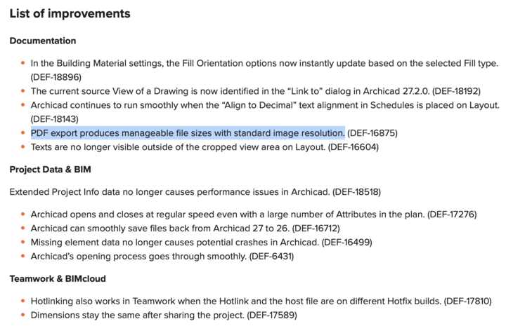

Supposedly this long standing issue was resolved in Archicad update 27.2.1, but it seems that the problem persists. Please can someone at the technical team from Graphisoft clarify why this keeps being an issue? It is a huge problem that after publishing the users need to compress the PDF's just to be able to issue the drawings with the requirements of public authorities, which generally have a size file limit for uploaded documentation. It is a real problem that should be easily solvable out of the box without external manipulation and that is affecting all Archicad users.

How interesting, @Jaime-airc_digital. I am guessing your screenshot is from this URL: https://graphisoft.com/downloads/archicad/updates/archicad-27-2-1
In this case, I would appreciate someone from Graphisoft clarifying what 'manageable file sizes' means in this sentence; or to confirm that the statement is false and that the PDF output is, in fact, completely unmanageable for all intents and purposes.

Maybe that defect fix is in reference to a different problem?
Maybe it is about placing an image file as a drawing in Archicad and then saving as a PDF.
The problem here seems to be when "Surface - Texture Fill, Shaded" is used in the elevation settings.
Also other texture fills and symbolic fills use in plan, elevation and section can affect PDF sizes.
The defect fix does not specify that it is this "Surface - Texture Fill, Shaded" problem that is fixed.
All the more need for clarification, then, on what "DEF-16875" was and where we stand on the issue of exporting elevations/sections with texture fills.
