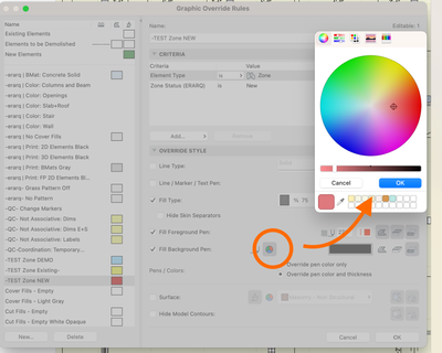

This is not completely correct, in AC26 you can use colors that are not part of a Pen Set for background fills and for surfaces. What is missing is to add it to lines which hopefully is on track to be added.
The other point is that using GOs you have the flexibility to simplify your Pen Sets.
Because GOs can override color and ignore pen width that means you only need as many pens as required widths (say 10) and that will leave 246 swatches to define custom colors.
