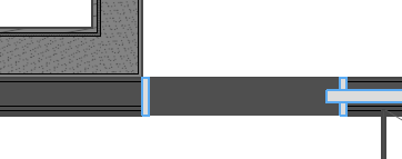

Graphic Override - How to not cut through door?
architect
I added a graphic override for NEW STATUS walls, so that any new wall turns a darker gray/black.
How do I prevent the door opening from being that same override color and instead have it white?

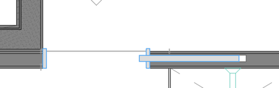

So, more like this at the door opening:

Within the door settings, I believe this is the setting you want to uncheck
AC24 / AC26 / AC27
Win10

Or you just do not override the cover fill of the door/window.
