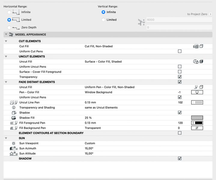

Dear All,
To this unfortunately closed post:
https://community.graphisoft.com/t5/Documentation/shadow-in-sections/td-p/253564
This topic is not resolved entirely because clearing the fills with the advised GO setting is possible, but only for the "foreground" area shadow.
The GO setting strangely does not influence the shadow in the "fade distant element" range of the view.
Any ideas or tricks for that?
Thank you.
Kind Regards
Roman
