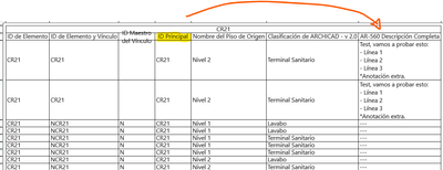

Hi @Davor P
Thanks for that thread to go on.
With this, we have created an Excel file with the following 3-column format:
COD_-_Full description_-_Budget item_-_
We copy and paste everything from Excel to a project info property. We have created one for each category of element: walls, flooring, ceilings, furniture, etc.
We continue to maintain composites, complex profiles, and surfaces with the following format:
COD_-_Short description
Finally, some SPLIT expression properties search for that code and return what they find to the right of it (full description).
This way, we can maintain long descriptions, respect line breaks in the source text, and link them to elements in the model.
We use the same method to assign the starting code to each element directly from Excel.
This way, we don't need to reserve all the elements to modify their description or starting code.
Translated with DeepL.com (free version)

We have an update on this issue.
When using linked modules, we have detected a problem, It is unable to return information from the linked modules.
We have tried the following options:
Source Property (expression) Project Info Works Comment
HOTLINK Hotlink + Host Hotlink + Host The properties and parameters in the project info are present in both files and are identical.
HOTLINK Hotlink + Host Host The properties are present in both files and are identical. The parameters in the project info are present in both files, but are only filled in on the host.
HOTLINK Host Hotlink + Host The properties are present in both files and are identical. The parameters in the project info are present in both files, but are only filled in on the host.
HOTLINK Host Host The properties and parameters in the project info are present only in host file.
HOST Host Host ✔️ Initial solution, where everything is in a single file.
For clarification purposes, we have modified the properties to use the Primary ID (which does not add the module ID) instead of the element ID.
