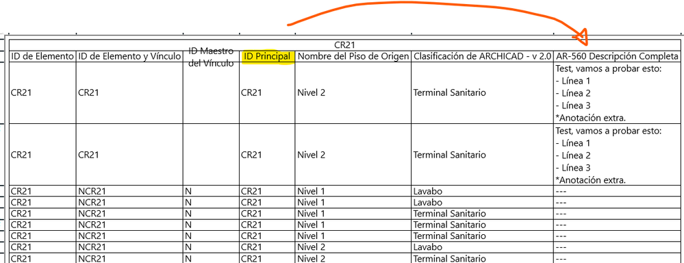

We have an update on this issue.
When using linked modules, we have detected a problem, It is unable to return information from the linked modules.
We have tried the following options:
Source Property (expression) Project Info Works Comment
HOTLINK Hotlink + Host Hotlink + Host ❌ The properties and parameters in the project info are present in both files and are identical.
HOTLINK Hotlink + Host Host ❌ The properties are present in both files and are identical. The parameters in the project info are present in both files, but are only filled in on the host.
HOTLINK Host Hotlink + Host ❌ The properties are present in both files and are identical. The parameters in the project info are present in both files, but are only filled in on the host.
HOTLINK Host Host ❌ The properties and parameters in the project info are present only in host file.
HOST Host Host ✔️ Initial solution, where everything is in a single file.
For clarification purposes, we have modified the properties to use the Primary ID (which does not add the module ID) instead of the element ID.
