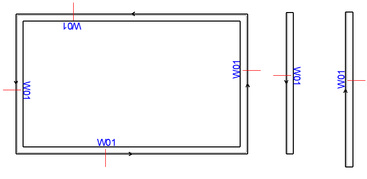

NCS Wall Label 25 is having problems with orientation, and ignoring ‘Always readable’. The problem remains on mirrored walls, and ‘Flip Label’ doesn't change this. The only sort of workaround I found was inverting the wall reference line direction. Is this a bug? Is there a simple way of fixing it on the script?
[Also, label doesn't really work with mirroring at all.]

After some tests, I believe this is not a bug, but just a limitation of the label. The same thing happens way back in Archicad 22.
What happened here is that the label orientation always follow the wall's direction. If you enable Wall & Beam Reference Line, you can see that the label follow the direction from left to right
When we mirror a wall, the direction also changes, thus the label is flipped.

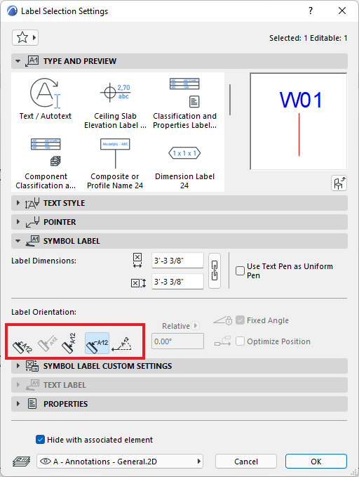

To control the label orientation exactly, I suggest looking for this option in the Label Settings
I hope this helps you with the problem. Please let me know if you have any further questions!

Why can't the always readable function just be made to work in this important label? The above solution looks very bad on slanted walls.

Looks like the same problem has persisted into AC26 - W-03 really looks strange upside down (see image).
