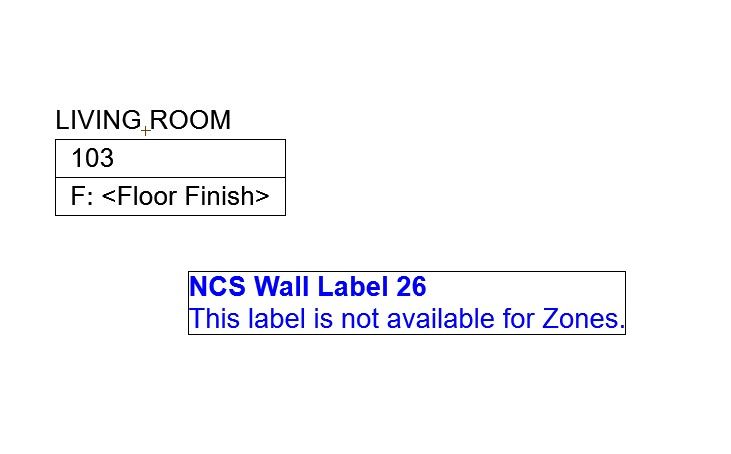

Zone Label comes with NCS wall label
Gisele

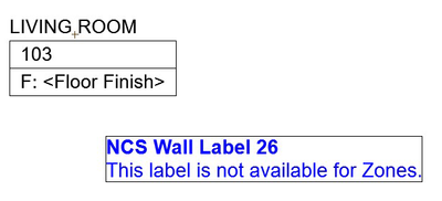

When I place a zone label, I also get a "separate" wall label that I can delete. Not sure how to restore the zone label.

The additional label is most likely due to this option being selected
If you unclick that box, no additional label will be added.
If you want a specific different label, create and place whatever you want, and eye drop to pick up those parameters..
Next time you go to place a zone, it will place that label along with the zone/stamp.

What I think happens here is Gisele is placing a Zone with its Zone Stamp (the black one), and because of the setting JeffH refers to, a Label is also placed for the Zone. Probably a Wall Label is selected by default and this is why a Wall Label is placed along the Zone Stamp.

not sure why 2 zones would appear, but out of curiousity, what Zone Stamp is currently called up in your Zone Category settings???
(Options > Attributes > Zone Categories)
