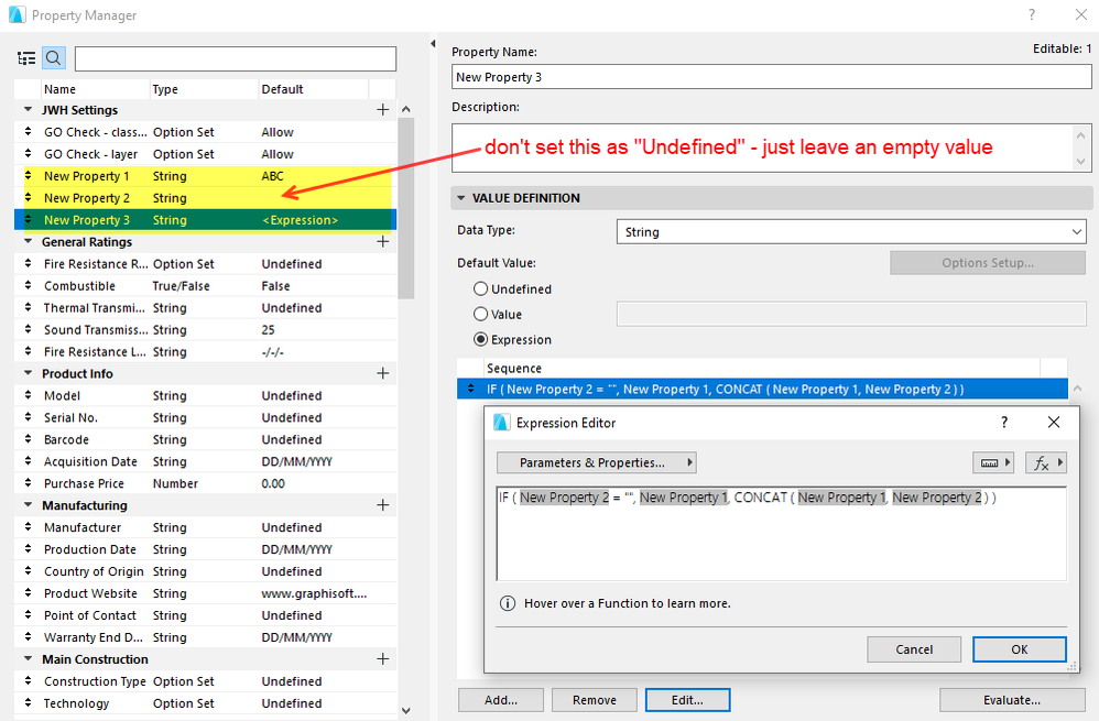

I am not sure if you can check if a property is "undefined".
At least I couldn't get it to work.
But if you give it an empty default value you can do this.
OK I completely missed ISUNDEFINED.
Still learning. 😀
I guess thats the point of the community ðŸ˜‰
AC28 NOR 3001 (WIN)
