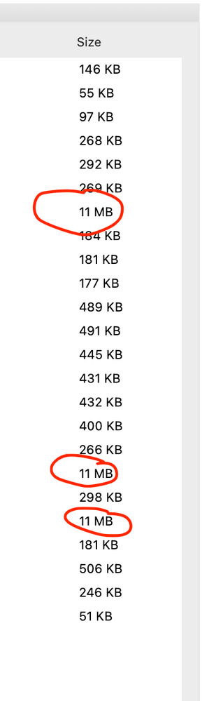

 I'm working on a project that has about 20 drawings. These are large/complex plan drawings of a full floor of a tower block, full of partition walls, offices, chairs etc. When I export the drawings, the majority export as PDF between 200-500KB, with three drawings in the package exporting at 11MB.
 I can't figure out why these three drawings are coming out so large, and the architect I'm working for is persisting with me that I need to reduce the file size.

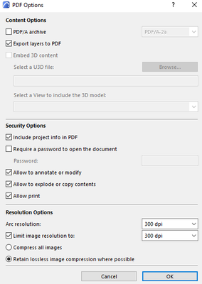

 Thanks for the quick reply! I've just tried the PDF document options, thinking that if I didn't export layers, it may help. Sadly it hasn't made a difference.

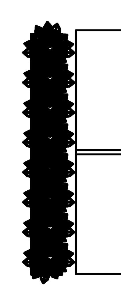

 There was a 3D object of a planter box that was used in the drawings (in plan view only showing in 2D), that was very polygon heavy. I created a new 2D object that was a basic outline of the planter box. There were 3 of them on each of the 3 drawings that were having issues. The drawings have gone from 11MB to 260KB.
Far more reasonable!
Thanks so much for your input and advice!

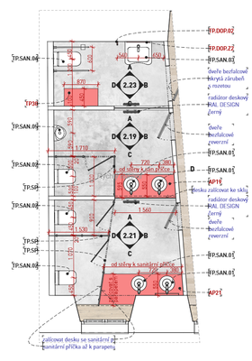

I am having the same issue.
I am using downloaded BIM objects which I use as a reference for interior design project.
Unfortunately the option to lower polygon - does not take the effect to the object.
I also use textures in interior views to clarify the final result. Textures are sesamless about 1000px and everytime under 500kb.
This one PDF takes around 30Mbs. Its too large. I have over 50 of theese.
Any suggestions? Thank you for any help.
Filip
