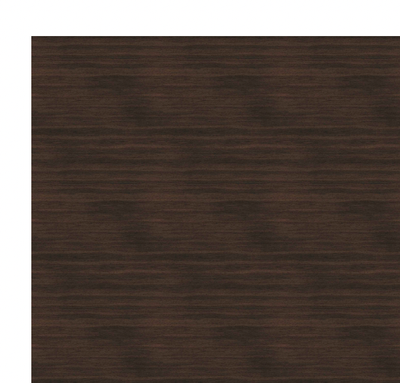

kimaa
my case, it's visible even in print(paper).

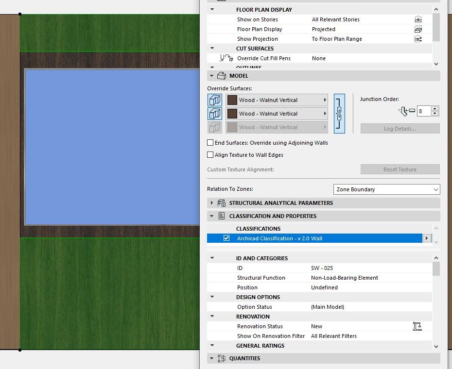

kimaa
Timber texture problem. the dark wood texture is archicad's "Wood Walnut Vertical".

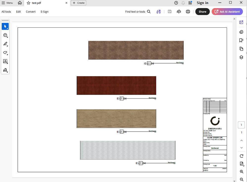

i have uploaded my test file. same problem. thanks.
I just published your test elevation (using 29) and it all looks fine as a PDF opened with Acrobat reader.
Looks fine on screen but i am unable to print it on paper as I don't have access to a printer at the moment.
PDF file attached here.
Is this any different for you?
