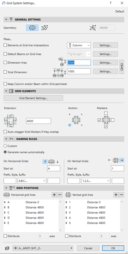

can I copy dimensions?
can I copy dimensions? - Graphisoft Community
I connected the grid to the dimensions of the basement 2nd floor, and I want to copy the dimensions to the basement 1st floor. However, it is not copied. Is it the same method as explained in the link below?
ArchiCAD does not understand dimensions.
If there is a hotspot at the location where you copy and link, it seems like you can create the dimensions by programming it....
Is there a reason why you do not do it in Graphisoft?
I want to know about the dimensions pursued by Graphisoft.
Solved! Go to Solution.

1. If you use the Grid system
you don't need to create several grids on each floor as long as you select show on story: All Stories
2. Automatic dimensioning, yes you can use it but it depends on what you want to achieve like for example you want to dimension wall openings.
For dimensions on the Grid I will use the grid system dimension so it will be automatically displayed on all stories.
3. Not sure as well but maybe to avoid confusion with actual text and dimension elements. (no idea just guessing)
4. It won't add hotspots on Girds you need to manually place them...
It will really depends on your workflow... For me I would duplicated the dimension that's generated from the Grid system and then from there I will just press and hold CTRL and click the elements that I want to have dimensions, if this will be time consuming maybe I will use Automatic dimensioning if i will get the job done quicker. Another one is I will do the hotspot and dimension in one floor then grouped them and copy it to the floors that needs that dimension. It really depends.

2024-12-30 01:11 PM
You can copy dimensions without using the Grid System (or when it stops updating) but it might not be as fast as dimensioning again showing the previous story as a Ref:
- Select grid dims you want to copy (or any other dim)
- Open Dim Settings and select "Static Dimension"
- Close settings and use CMD/CTR+C to copy the Dims
- Use CMD/CTRL+Z to undo convert to static
- Go to the next story to dimension and use CMD/CTRL+V to paste
- Then you need to relink the dims to the object by selecting the nodes and clicking were they are supposed to measure. You could leave them as static if you are a monster and can live like that and not spend the time relinking them but that is not recommended.
Alternative is to do the above steps once for your template for 5-10 stories and when you start your project you edit the grid as necessary. Removing individual grids is no issue but adding extra ones will need to edit the dim chain in each story.

2024-12-30 03:33 AM
Hi, If you want use the Grid System then within the Grid System settings you can assign dimension on your grids and it will be carried out on the different levels.
but if you want to copy a dimensions it won't simply work...
What you can do is use a hotspot then place the dimension on that hotspot then you can copy the hotspot and dimension altogether it will preserve the dynamic function of the dimension as well.

2024-12-30 04:00 AM
1. it will be carried out on the different levels. I don't know if I misunderstood what you meant, but are you saying that I should create a Grid for each floor or that each floor will have a dimension?
2. Automatic dimensions are not applied to the Grid.
I asked this question because it seems that you can apply it sufficiently and use it, but you don't.
3. I wonder what the intention is of not being able to copy it.
I don't think it's impossible, so I think it's because you don't want to do it.
I wonder what Graphsoft's intention is.
4. I need to use 4 hotspots to link the dimension lines to the Grid. In order to display the locations of columns, beams, etc. as dimension lines on the Grid, I use 4 invisible hotspots to display them as lines at the locations. Is there another method that I should study?
Here, I also want to know Graphsoft's rule that when you use dimensions on the Grid, it doesn't automatically add hotspots to the Grid so that you can link them.
