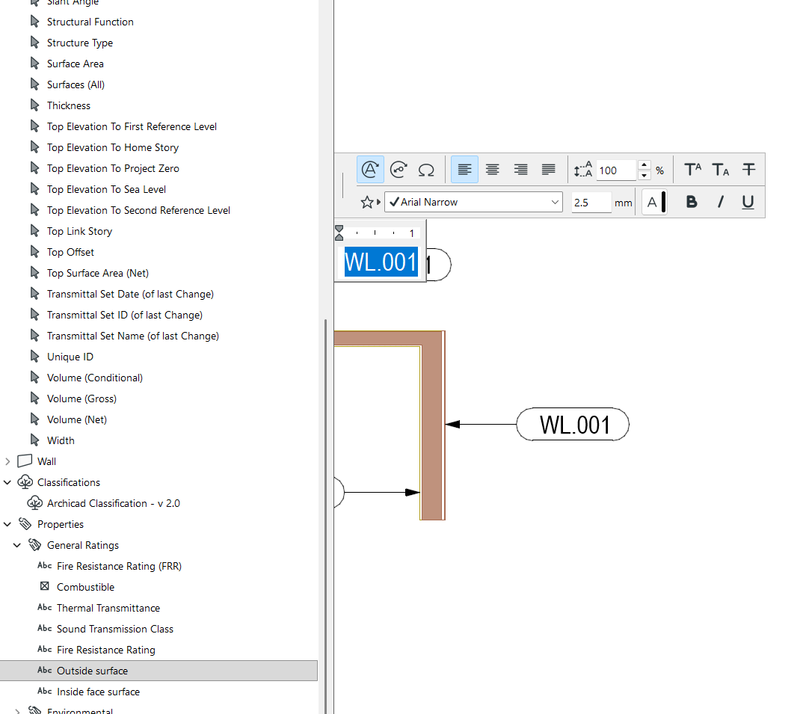

https://community.graphisoft.com/t5/GDL/Hack-the-Surface-Label/td-p/621379
https://community.graphisoft.com/t5/GDL/GDL-Multi-Use-Code-Label/td-p/706119
Once you have determined the element type, you can pull any of the Override Surfaces available to that element. If an Override is not active, it will pull the surface assigned to the exterior building material on that side. For the Edge, if you are labeling a Composite, it will always show the Override whether it is active or not.

Todd Thomas
This thread was exactly what I was looking for.
Am I correct in saying. If I override the wall surfaces with the WL.001 and WL.002. When I come to select the autotext (Finish code outside) I need to make sure I am choosing the right surface. Is there anyway it can read what the surface is and still do the split ?
