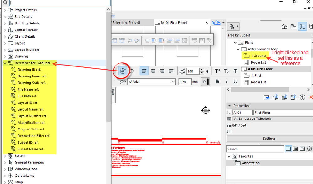

You can set anything on a layout as a 'Reference' and then you can use autotext to access certain values of that reference, but it is only things like the layout page number that reference is on.
These are the available reference values, I don't think this is what you are looking for.
