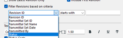

Lingwisyer
Guru
"status of the project placed in custom par 2 of the layout"?
If it is information stored within each layout, why not just use the default Layout Status input? Not quite sure how it is retrieved, but the default Revision History Detailed object uses it, so you could delve into that to see how it works.
