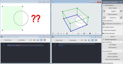

Can any variation or setting of the PROJECT2{??} function show the results of an SEO operation on a GDL object in a 2D plan?

3 weeks ago
Not that I know of.
Project2 is simply showing what was scripted in the 3D script.
The 3D script has no idea of how the object is being affected by an SEO, just that is is being affected by an SEO.
All you can do is determine if an SEO is taking place and offer an alternative script which the Project2 could show.
But the alternative script is what you tell it to do, not what is actually happening with the SEO.
Does that make sense?

in general, SEO's don't translate through to plan view, regardless of which tool is used. I think because the SEO trimming body does not actually 'trim' the element. The geometry still exists above/below/inside the target element(s); it just doesn't show (until you select the elements).
so a plan view of an object using project2 is still showing the projection of the 'hidden' portions of the object.

Not an answer but maybe useful or related, depending what you need the SEO to do.
1. If you need to see the true projection with the cut, you can create a plan 3D document
2. Finalise the operation - convert to morph
3. Project2{4} has an option of cutplane and you can set its height
4. SEO inside GDL with SUBGROUP command but this means operator needs to be part of the object

Many years ago, Cutting planes appeared in ArchiCAD; they were cool and easy to use, but they had limitations.
Therefore, I created an alternative solution with a dynamic model cutting mechanism, using a special OperatorSEOmobile object (built-in shapes: plane, cuboid, cylinder, etc.). Importantly, you can add a tag to each OperatorSEOmobile object.
The OperatorSEOmobile object "appears" (and cuts the model) or "disappears" (and doesn't cut the model) depending on the MVO settings.
MVO recognizes OperatorSEOmobile tags and uses them to filter the "showing" or "hiding" of specific OperatorSEOmobile objects to achieve the desired SEO effect.
Everything works great in the 3D window, but unfortunately, cutting GDL objects, among other things, doesn't translate dynamically to the 2D window.
Recently I decided to learn more about and use PROJECT2{?}... to show GDL objects in a 2D projection window cut by OperatorSEOmobile, but it really seems impossible for now.
