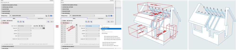

Many years ago, Cutting planes appeared in ArchiCAD; they were cool and easy to use, but they had limitations.
Therefore, I created an alternative solution with a dynamic model cutting mechanism, using a special OperatorSEOmobile object (built-in shapes: plane, cuboid, cylinder, etc.). Importantly, you can add a tag to each OperatorSEOmobile object.
The OperatorSEOmobile object "appears" (and cuts the model) or "disappears" (and doesn't cut the model) depending on the MVO settings.
MVO recognizes OperatorSEOmobile tags and uses them to filter the "showing" or "hiding" of specific OperatorSEOmobile objects to achieve the desired SEO effect.
Everything works great in the 3D window, but unfortunately, cutting GDL objects, among other things, doesn't translate dynamically to the 2D window.
Recently I decided to learn more about and use PROJECT2{?}... to show GDL objects in a 2D projection window cut by OperatorSEOmobile, but it really seems impossible for now.

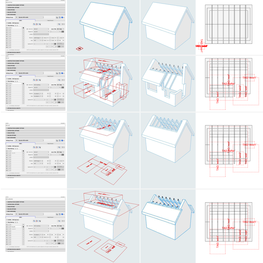

1. A key aspect of MVO is TAG filtering for operators (with your own simple miniRegEx).
Based on this, specific behaviors can be enforced for individual OperatorSEOmobile.
This is somewhat similar to the graphic combination override mechanism, although it is more modest and limited to 10 levels of TAG filtering for OperatorSEOmobile.
Of course, by disabling MVO filtering, you can easily and simply enforce specific behaviors for ALL OperatorSEOmobile simultaneously.
As an aside, each OperatorSEOmobile has a simple toggle: whether it should respect MVO settings.
2. OperatorSEOmobile excluded from SEO or, conversely, participating in SEO (according to TAG filtering in MVO settings) can be subject to any combination of settings:
- move them "far, up, down, etc.", i.e., outside the area of ​​influence;
- change the XYZ dimensions (e.g., reset the operator's body height to 0 or increase the height to create a solid from the plane);
- enable the wireframe without SEO influence (MODEL WIRE);
I usually use a downward offset (maximum below the entire model/building, e.g., -10 m) for OperatorSEOmobile excluded from SEO – it's the simplest 🙂.
For clarity, I store OperatorSEOmobile on a separate layer.
As a rule, OperatorSEOmobile excluded from slicing always switch to wireframe mode (MODEL WIRE) in the 3D script.
As a side note: active operators can be DISPLAYED as wireframes for clarity, but of course, in the 3D script, they act as SOLID MODELS.
3. How OperatorSEOmobile works:
- I insert OperatorSEOmobile into the project (+ select its native, simple shape: wall, cuboid, cylinder, etc.);
- I perform standard solid operations on design elements;
- Of course, you can further adjust the position/size of OperatorSEOmobile by observing how it cuts design elements;
- It's worth assigning a TAG in the OperatorSEOmobile settings so that MVO can consciously enforce the behavior of this OperatorSEOmobile.
4. How MVO works:
- At the highest [1] level of filtration, it imposes a common behavior (e.g., leaving the SEO influence zone) for all OperatorSEOmobiles, hence the filtering criterion: "*".
- Then, at subsequent levels [2], [3],...[10] of filtration, you can individualize specific OperatorSEOmobiles, meaning, for example, that they remain in their original location and thus influence SEO cuts.
- This means that the combinations of OperatorSEOmobile behaviors are, in a sense, cascading from the first to the last active filtration level.
Of course, in terms of GDL, most of the above-mentioned processes are not performed by the MVO, but by each OperatorSEOmobile individually.
This means that each OperatorSEOmobile checks whether its own TAG meets the MVO's cascading filtering criteria and analyzes the behaviors it should be subjected to.
In short, thanks to MVO, only the OperatorSEOmobiles that are supposed to clip something in a given view remain on the stage (and usually in their original position). The remaining OperatorSEOmobiles are supposed to move as far away from the stage as possible in that view (and not clip anything!) 🙂
