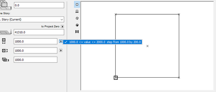

values "A" range[1,2] step 1,0.2
values "B" range[1,2] step 1,0.2
note: my working units are mm for this example.
Note: Archicads coding units are meters.
for "A"  you have values in meters of
1.0  <- reference point
1.2
1.4
1.6
1.8
2.0
for "B"  you have values in meters of
1.2
1.4
1.6
1.8
2.0
change the range to a starting point for A to 1.110
change the range to a starting point for B to 1.333
values "A" range[1,2] step 1.110,0.2
values "B" range[1,2] step 1.333,0.2
(now this offsets the vales of A by 0.111 and offsets the values of B by 0.133)
1.111 <- reference point
1.311
1.511
1.711
1.911
1.133
1.333 <- reference point
1.533
1.733
1.933
I hope this helps

Script example
fill "25%"
poly2_b{5} 5, 3, 3, 3, 1, 1,
0, 0, 1, 0, 0, 1, 0,
0, 0, 1,
A, 0, 1,
A, B, 1,
0, B, 1,
0, 0, -1
you get values for A of
1m <-reference point
1.2m
1.4m
1.6m
1.8m
2m
you get values for B of
1.2m
1.4m
1.6m
1.8m
2m
if you change the reference point, and step values to:
values "A" range[1,2] step 1.5,0.15
values "B" range[1,2] step 1.333,0.123
1.05m
1.2m
1.35m
1.5m <-reference point
1.65m
1.8m
1.95m
1.087m
1.21m
1.333m <-reference point
1.456m
1.579m
1.702m
1.825m
1.948m
I hope this helps.
