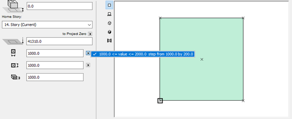

values "A" range[1,2] step 1,0.2
values "B" range[1,2] step 1,0.2
note: my working units are mm for this example.
Note: Archicads coding units are meters.
for "A" you have values in meters of
1.0 <- reference point
1.2
1.4
1.6
1.8
2.0
for "B" you have values in meters of
1.2
1.4
1.6
1.8
2.0

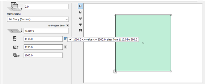

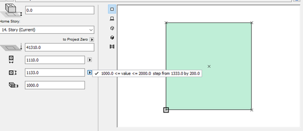

change the range to a starting point for A to 1.110
change the range to a starting point for B to 1.333
values "A" range[1,2] step 1.110,0.2
values "B" range[1,2] step 1.333,0.2
(now this offsets the vales of A by 0.111 and offsets the values of B by 0.133)
1.111 <- reference point
1.311
1.511
1.711
1.911
1.133
1.333 <- reference point
1.533
1.733
1.933
