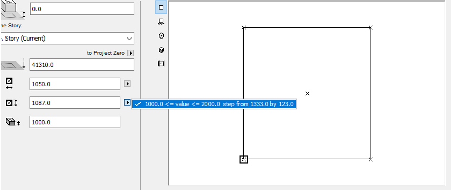

if you change the reference point, and step values to:
values "A" range[1,2] step 1.5,0.15
values "B" range[1,2] step 1.333,0.123
you get values for A of
1.05m
1.2m
1.35m
1.5m <-reference point
1.65m
1.8m
1.95m
you get values for B of
1.087m
1.21m
1.333m <-reference point
1.456m
1.579m
1.702m
1.825m
1.948m
I hope this helps.
