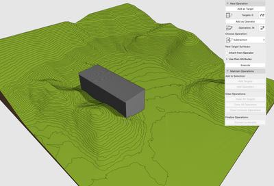

I would guess it is a model issue again and not the Mac.
  • 4000'x4000' terrain with a lot of nodes
  • subtract 75 walls 400' long and 400' High
  • Time 10 seconds with 3 other ACs open.
As a test change the Intersection Priority (In Layers) of the elements you are using to subtract from the mesh

Rotating 50 walls 6 seconds to rebuild

Adding 81 slabs (100'x100') and SEO with Upward extrusion ±50 sec

But AC25 running in emulation is only a little bit slower.
On another note an SEO of 75 walls is slower than the one for 81 Slabs.

Ok, Graphisoft Support send me an email, saying that the problem is yet the model not the Mac: 27,000 polygons in my Mesh it seems too much 🤔 ...but Apple say that my computer is INSANELY GREAT :))) WTF.........

Ok... 27000 polygons is too much for Apple M2MAX...
But "max" what??? 👹
Or the problem is the "brain" of Archicad "apple silicon"...
The one above has 107,305 without issues on M1.
SO I would guess that there is something wrong with your Mesh or with your SEOs
