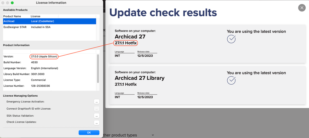

Another related issue is the completely nonsensical versioning. Is it build numbers or main version + decimals? How many decimals should we expect, is the next update 27.2, 27.1.2, 27.1.1.1? Who knows. And it appears Archicad is just as confused as I am…

So actually I believe Geoff is on the right track.  Because of the confusing labeling by Graphisoft , there is a chance that I was able to install the 27.1.1 Hot fix which I guess is version 4030? No way to tell .......
I thought the update was not installed because with this new version I was still unable to save a 27 doc to 26.....but maybe they never got around to fix that and maybe fixed the freeze when I use the text tool.
