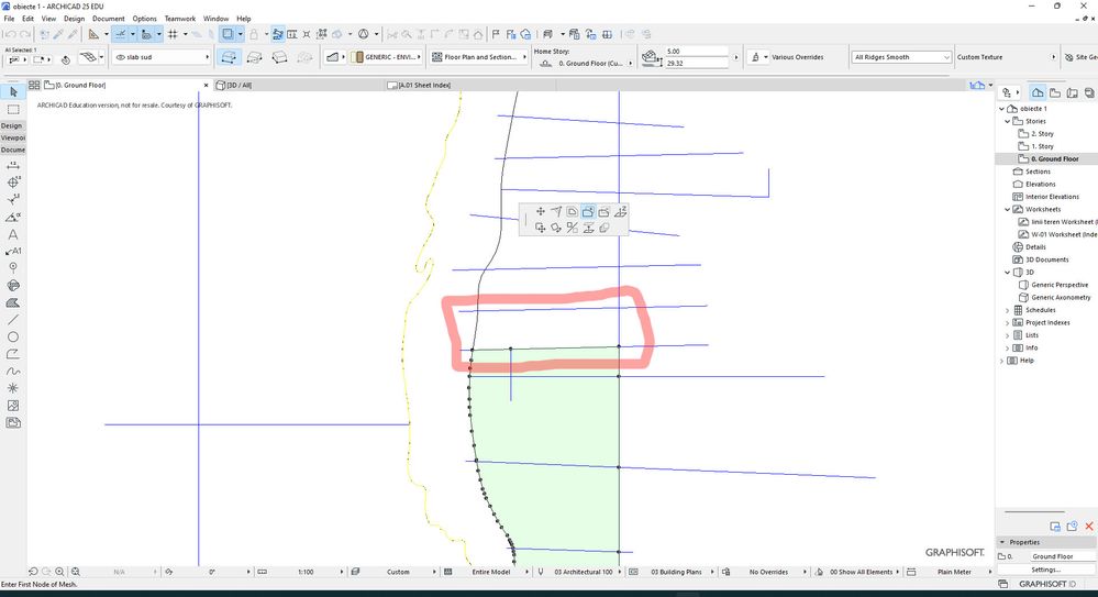

Hello. I would also like to comment on this issue. I have been having problems with the magic wand tool aswell, for as long as i can remember. (this is the case for Archicad 22 to 25)
I am working with maps, mostly, and this error is starting to get the best of me.
The program crashes when i want to subtract or add to the shape/contour that i am working on.
i tried to tweak the magic wand settings, but to no avail.
This error happens if you're working with a slab, a mesh, fill or anything else.
If you-re doing topographic builds, this error is your worse enemy.
The only slight improvement is to divide the irregular spot you want to add to your fill into smaller pieces... but even then, the program keeps crashing.
Another solution is to draw the contour yourself by hand, but that takes alot of time and feels to be totally inefficient.
I attached an example, and ac25 file and a jpeg. you can observe in the jpeg attachment that once i click spacebar and drag my mouse over the area highlighted with red, the loading circle appears, and after a minute, the program crashes.
any ideas on why this happens? For example, when i try to fill shapes or contours in adobe illustrator, it selects the contour right away, but i deduce that the programs have different ways of doing and calculating things.
You can try to add to the polygon in the Archicad file and see the results and the error yourself.
i look forward to hearing from anyone in the Graphisoft team or whoever has a solution to this issue.

-the magic wand setting helps a bit when defining the fill within the area , but the crashing is still ongoing. in other cases.
-i also tried switching to a much more powerful operating system, but that did not help.
