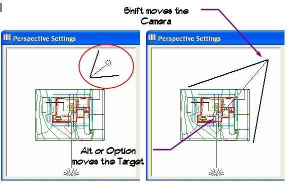

My guess is that you are looking away from what you want to see. When you look in the Perspectives Settings dialog box can you see the camera and target or is it looking away from the building? (circled below)
If you can not see the Target holding down the Alt key (WIN) or Option key (MAC) and clicking on what you want to look at sets the Target; holding down the Shift key and clicking where you would like the Camera to be sets the Camera.
