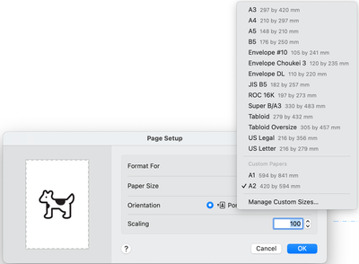

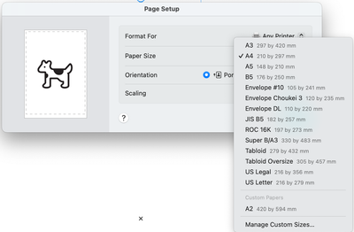

Not sure if this was resolved. I went simple method of adding to any printer option in page settings required paper size under manage custom sizes.

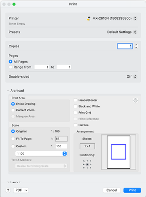

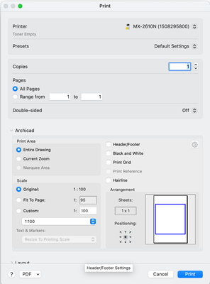

Then set that size to be active with any printer. Once I picked print option and changed to printer to be used it seems to have taken previously chosen size for printing. Couple of screenshots showing different sized paper below.
Not sure if this will do as workaround. Also note that Safari is not letting us reply to topic hence my reply using Microsoft Edge.  

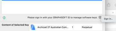

Now for the more pressing issue that came up after installing Preview AC27 3.0 update. After installing it licence manager now doesn't let me sign in to server to upload licence. After pressing Sign in button all I get is greyed out button and no pop up dialog shows up to sign in. Only solution is to quit and we have ne means of uploading our licences at this point so lets hope no issues arise whilst solution is found.
ArchiCAD 27.2.2 Hotfix did not have this issue.
Be sure to contact Central Innovation with this problem.
I have not yet installed the 27.3 preview, but it is certainly all working with 27.2
Are you able to upload the license key directly from Archicad rather than using License Manager?

@Sinisa Lazarevic,
Thanks for that. This could be a workaround until either Apple or Graphisoft fix the issue. I suspect it’s Apple as it affects most software where Page Setup is available.

I am not well versed on contacting "powers to be" so happy for any of you to do that on my behalf regarding inability to upload licence via licence manager tool.
