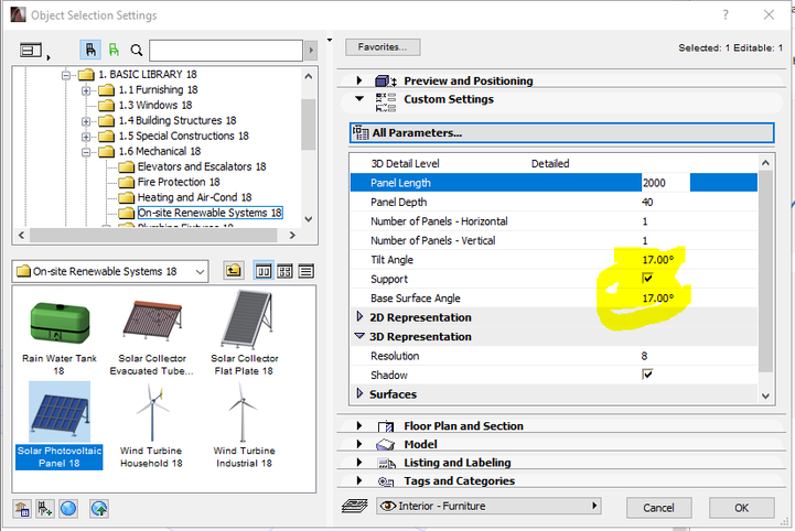

I'm happy to report that after struggling for hours to rotate a solar photovoltaic panel 18 to align it with the roof angle, I finally managed to do it successfully. You just need to go to the object selection settings (while in the 3D view to visualize it easily) > custom settings > All parameters > Tilt Angle (roof angle) > you may tick support > Surface Base Angle (roof angle) > Ok. Voila!
That is a setting that is coded into the object itself. Other objects may have similar settings if the scripter deemed a varying angle to be a typical situation.
