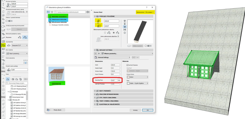

I've got a problem with the native Dormer Shed in Archicad 25 and 28. I think its maximum Shed Roof Pitch value (screenshot) is hardcoded at 35 degrees. This is highly impractical and illogical limitation, and it should be increased to something like 89 deg. Sadly, I can't edit GDL myself, so I'm hoping someone would be able and so kind to try fixing it.
I placed it as skylight but the issue is the same if placed as an object.

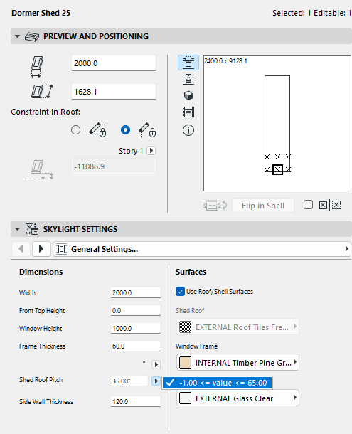

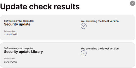

Not sure which library update you are using in AC28, but I am on Update 1 and the maximum pitch is limited to 5 less than the roof pitch.
Ling.
Win11 | i9 10850K | 64GB | RX6600 Win11 | 5900X | 32GB | GTX2080TI
Are you placing this object on the roof with the sky light tool rather than just as an object?
It should then automatically read the roof pitch and adjust to suit.

When I place the dormer with the sky light tool, the shed roof pitch is limited to 5° less than the actual main roof pitch that you are placing it in.
So please make sure you are using the sky light tool and not the object tool to place the skylight.
I also see it is locked at 35° when using the object tool.
Using the skylight tool, it will also cut a hole in the roof automatically and it will be associated with the roof, automatically reading the roof pitch and adjusting the allowable settings to suit.
If you use the object tool to place it, this will not happen.

In the Original Post;
Yellow shows it placed as a skylight tool-selected and editable.
Green shows it as an embedded object
Blue shows that there are no other linked libraries.

when I test "Dormer Shed 25" placed as a skylight placed in a 70° roof
although the range says "-1 to 65" for my 70° test roof, when you type in the value "60" it reverts back to the default "40 - 5"  = "35"
keeps popping back to 35.
Today it is repeatable;
Although when I did the same test on Friday with the "Dormer Shed 25" i thought it worked with the slope of 65 being input, but today it didn't...

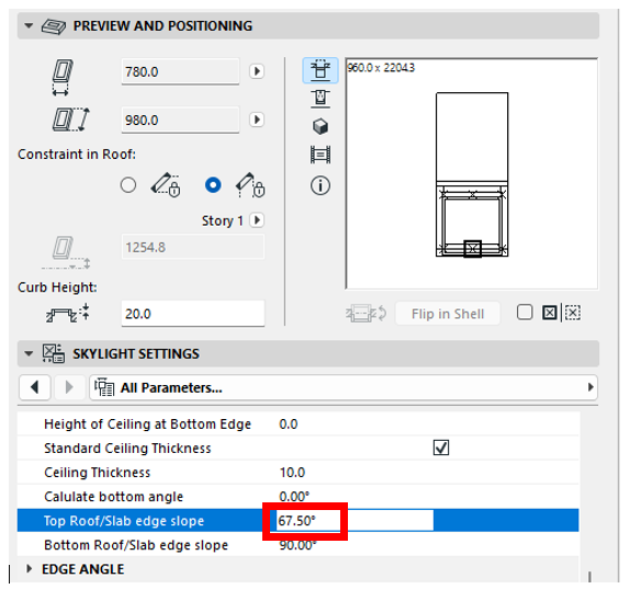

P.S. it was for the 2D symbol for skylights with Light shafts attached(the Velux range of skylights) i discovered the problem...
The problem I had was for the light shaft calculation for the top edge of the ceiling, and the position for cutting the ceiling slab edge on the upper edge of the light shaft need the roof angle to calculate it.
I need it to calculate the upper edge angle of the ceiling slab cut based on the roof angle & the Light-shaft angle & the ceiling angle (calculated by dragging nodes in section)
cut the hole in the ceiling slab based on the hotspots/hotlines of the orange shape, had to edit the angle of the edge of the slab so the lining would pass through.
and in section the light shaft is a perfect match for the ceiling hole

Even when placing with the skylight tool, the default shed roof pitch will be limited to 35° when you look at the settings before you place the skylight.
But once placed on a roof and it is associated, it will read the roof pitch and allow a shed roof pitch up to 5° less than the actual roof pitch.
