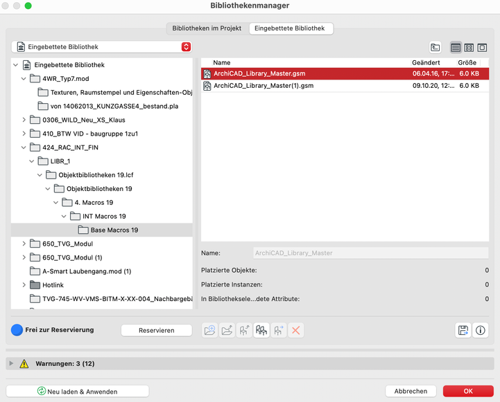

for some years now, we have been battling some unwanted Master GLD Libraries in our Teamwork projects. I have recently found out, that other offices are facing the same occurrence.
Let me explain what is happening...

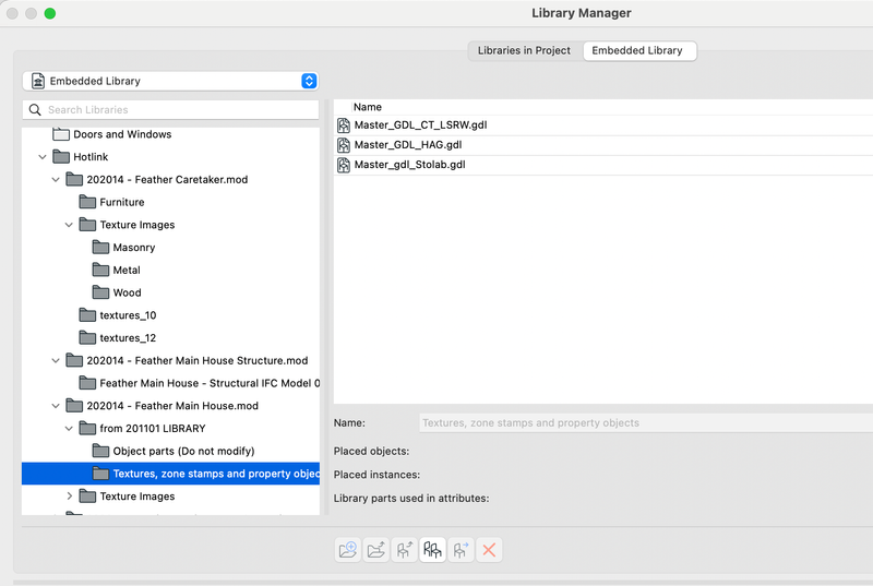

We start the project with a clean template, where only our standard libraries are available. During the project development, more or less after 1-2 moths, these libraries located in some strange folders start appearing.
or here
You will probably think that is it from copying elements from other files. I can guarantee that this is not the case.
We have also tried the option of cleaning all related teamwork files. Nonetheless, the libraries appear after some weeks or months again. Because we don't receive error messages of missing libraries (after deleting them), this means that these libraries are not in use. We started to notice this problem already in Archicad 24. We are getting these master GDLs:
MASTER_GDL_ArchiCAD_Library.gdl
MASTER_GDLVelux81de_DB.gdl
ArchiCAD_Library_Master.gdl

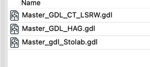

I`e been trying to get rid of Master GDL files in our office for the last 5 years, and they still propagate like a virus. No matter how clean a template is, once someone opens a older file and copies even a line/fill, then these GDL master files come into play. The one in the image attached is the cancer that keeps spreading and its from 2012, but somehow it keeps showing up in newer files.
This hoermann gdl i believe comes from a garage door manufacturer. I guess, someone used a bim components object once and now we are doomed.
This software is so hopeless lately(past 10 years)
