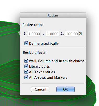

Eduardo Rolon
What error is it giving if any? If none then it looks like you will need to re-install AC because that is not normal.
Just to be sure, the steps are:
1. Select Object
2. Right Click on object and select convert to morph
3. Select Object
4. Edit-> Reshape-> Resize
5. Select either Graphically or unselect it so that you can use a %
6. If graphically then click to establish the base point, then click to define the existing dimension, then click to choose the final size.
7. If by percentage then write the % and then click to apply.

Eduardo Rolon
Step 5
