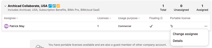

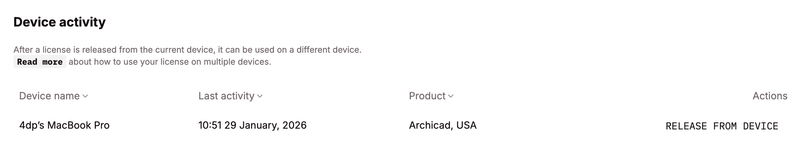

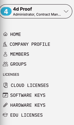

I have to go to graphisoftid.graphisoft.com to upload my key any time I switch computers for archicad or a bimcloud manager. It's annoying that this can't do it automatically; it's also a litle cryptic on where to release your license:
under your graphisoftID log-in, go to cloud licenses > select your Archicad license type > click the drop down > assignee, click the ellipses (...) > Details > Release from devise:

Cloud licenses are different to software licenses.
With software licenses, I believe you must release the license in the Archicad Help menu before you leave Archicad or do it through the License Manager Tool on the machine that currently has the license.
It can't be done from any other machine.
Cloud licenses can be released as you describe from any machine, so long as you log into the Graphisoft ID website.
Also if you set your cloud license as a 'floating' license, it should release automatically about 30 minutes after you close Archicad that is using it.
With a 'named' license. you have to go through the release process if you change machines.
