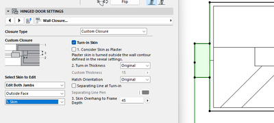

Hi everyone,
I’m working in Archicad 28 and facing an issue with composite wall finishes at door openings.
Problem:
In a composite wall, I want the plaster finish to continue behind the door frame, but currently the plaster stops at the wall face and does not wrap behind the frame.
I am using:
Composite wall with plaster as the outer skin
Hinged Door (standard Archicad door)
Closure Type: Finish Closure
Wall Closure settings enabled in the Door Tool

please have a look at how the plaster behaves with respect to the door frame, this is what i want
2026-02-07 11:02 PM
Uhh.... I don't think that any of the GS doors allow this; I've tried but didn't manage to accomplish this.
But on the other hand to have the plaster done like this is also highly unusually.

Could you use the Custom Closure? Do not think there is a way to merge the internal and external skins though...
The Plaster Reveal can do the same.
