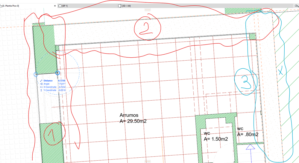

So i think im progressing, tell me if you thibk its a normal worflow:
1. I created walls nº 1, nº2 and nº3. They all have different thicknesses, so i had to create 3 different composite walls where the stone thickness was going to vary;
2. Wall nº3 i removed the plaster from outside skin cause its agains earth material;
3. Now i have a trapezoidal wall in the front façade but i cant seem to adjust its end thickness. i used the trapezoidal geometry, i tried changing the ending width parameters, tried hovering my mouse on some hotspot, but i cant seem to stretch that end in order to match it;
ALso, you said only one skin will change the thickness on a trapezoidal wall... couldnt it be the core changing its thickness?

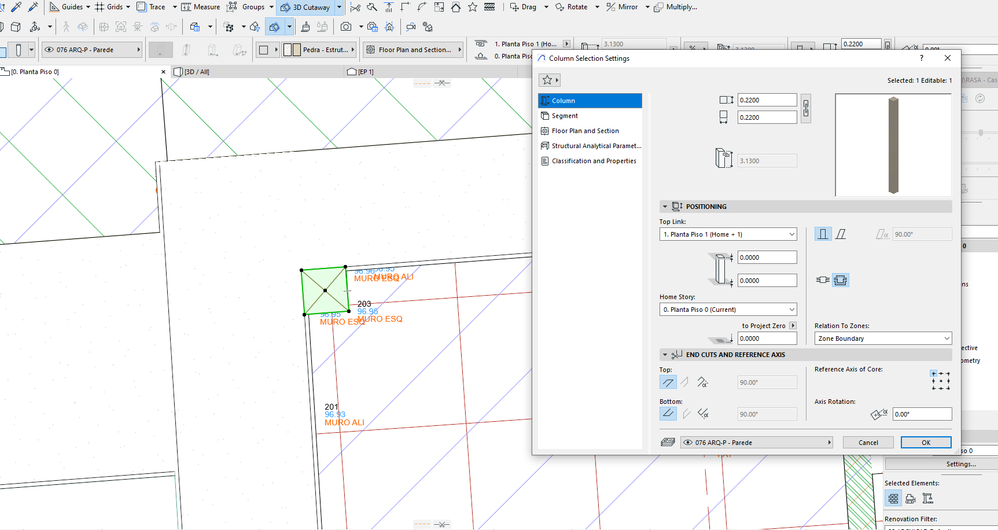

so i tried to get a pilar going on the corner in order to correct it, but:
1. I insert a pilar with the same building material
2. I chose the right wrapping method.
But im not getting the results, what am i doing wrong?

Now I have Archicad in front of me.
The plaster skin on the composite wall can not be a 'core'.
it must be 'other' or 'finish'.
The column needs to penetrate the Core of the wall. The Finish and Other skins will then wrap.
