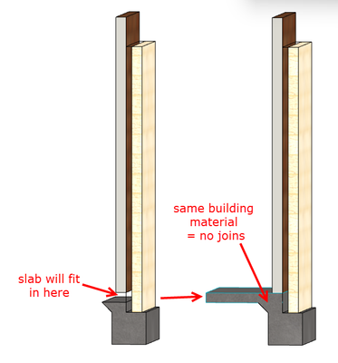

2023-12-08 11:38 AM
Your 3D diagram is like gold, I see what I need to do now. Yes my extended brick wall does cut the slab.
Your footing is a complex concrete beam profile ?
Thanks again Barry.
2023-12-09 03:40 AM - edited 2023-12-09 03:41 AM
No, it is all part of the wall complex profile.
Has modifiers to adjust heights and widths of almost everything.
2023-12-09 03:52 AM - edited 2023-12-09 03:52 AM
Cool ! So I could just draw a footing profile beneath the wall profile with a gap for a slab to fit under the internal skin like you have done here. Keeping the material of the footing the same as the slab.
Nice depiction of a detail to help me draft my profile. I have seen some other methods in videos but yours is the best one so far. I will try it out.
Thank you for your help once again.

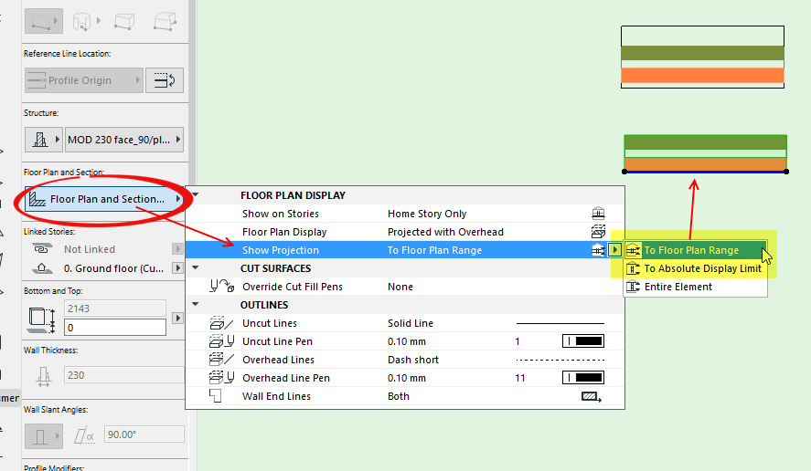

2023-12-13 04:48 AM
I tested it out and it worked fine with a couple of little problems that showed up.
1) You see the footing line on the plan so I changed my external walls to cut only.
2) On my external walls where the reference line is on the inside to line up with a corner internal wall intersection. When I apply the profile, the wall flips. Do I create another mirror image profile to apply to that type of external wall or is there another way around that hurdle ?
2023-12-13 05:08 AM - edited 2023-12-13 05:08 AM
1). You can adjust the 'Show Projections' settings as well so you don't have to set a s cut only.
2). Why do you need the reference line on the inside?
Walls should trim OK if inside or out.
2023-12-13 05:29 AM
Yes I will use the show projection settings instead.
