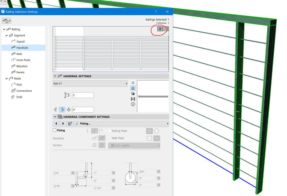

I am trying to use the Handrail tool with cable railing.  I need to add more rails and cannot.  Any
Eric Milberger
I need to add more rails and cannot add any more  need them 3.5-4" apart 3.5' High

JeffH
The + sign in the upper right should allow you to place as many as needed
AC24 / AC26 / AC27
Win10
But unfortunately you have to adjust the height of each rail by selecting it in the preview.
It is not possible to select them all and distribute to equal spacing.
Lingwisyer
Guru
Do a Complex Profile. Draw your cable profile then just use the Multiply function to set your spacing.
Of course but this is like going back to sticks because the calculator does not work.
Eric Milberger, Architect | Master Planner
Yes, we can distribute the spacing of posts and balustrades horizontally.
It would be great to be able to distribute railing spaces vertically as well.
Lingwisyer
Guru
Yeah, the lack of a vertical array spacing or similar is a pretty big oversight...
