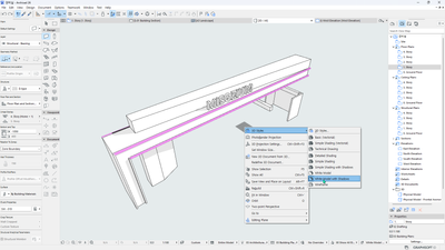

If color suddenly appears in white mode.
LeeJaeYoung
AC27 on window 11
9 REPLIES 9

I do not see how this is possible.  Strange!

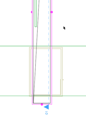

The pink (magenta) colour (set in the Work Environment) can mean the an element with top/bottom links to a storey has an invalid geometry (inverted geometry).
i.e. the top is linked 600mm below the storey which puts the top below the base of the wall.

AC27 on window 11
So, like the image, this phenomenon occurs
It is not fixed even if I move it, and suddenly I see a strange warning saying that the profile is open, and when I open, apply, and close each file, the pink color disappears.

AC27 on window 11
I am not sure it is a problem with the profile.
I think it is the heights to the top/bottom of your element.

thank you I think it's a bug.

AC27 on window 11
Trust me, it is not a bug.
It is an inverted wall.
The top is lower than the base.
The video in the help file I linked to explains it.
