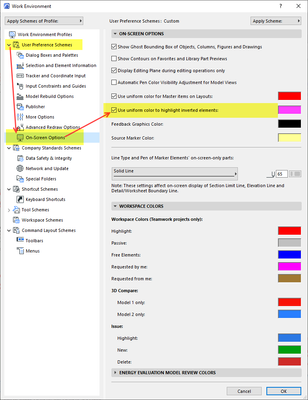

The pink (magenta) colour (set in the Work Environment) can mean the an element with top/bottom links to a storey has an invalid geometry (inverted geometry).
i.e. the top is linked 600mm below the storey which puts the top below the base of the wall.

LeeJaeYoung
So, like the image, this phenomenon occurs
It is not fixed even if I move it, and suddenly I see a strange warning saying that the profile is open, and when I open, apply, and close each file, the pink color disappears.

I am not sure it is a problem with the profile.
I think it is the heights to the top/bottom of your element.

Trust me, it is not a bug.
It is an inverted wall.
The top is lower than the base.
The video in the help file I linked to explains it.
