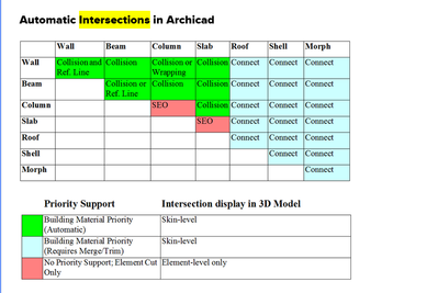

Not sure if this helps with the discussion, but here is some info about the automatic intersection of elements.
Nothing automatically connects/trims with a mesh.
For all other elements (from the on line help)...
And as Gwenor mentioned before, the automatic display order and overlapping fills of elements in section has changed in 26.

To summarize:
- Roofs and Meshes do not participate in Intersection Priorities. They never have
- The issue with Meshes is fixed by either "send to back" (no SEO) or using SEOs (which you don't want)
- The issue with roofs is to use the "correct" workflow which is "Connect->Merge" which could be argued it is a kind of SEO and this has been the correct workflow since Priority Based Connections were introduced. Also once you connect an element to a roof that will fix the display in all other sections so the job (based on your screenshot) is not huge.
- As @Patrick M indicated using SEOs correctly do not bloat the file and nobody has indicated that you have to SEO everything.
- As @Barry Kelly indicated AC26 changed fill order which implies reviewing your migrated files. AFAIK nobody had this type of problem as reported in the forum.
So my recommendation is for you to track the real issue (if Merge doesn't work we need more info) since based on the information given I don't believe that your migrated files sections are "simply irresolvable" just that we don't know the real reason (or issue) beyond not using the correct workflow to connect Roofs and your refusal to not use SEOs. With that info please open a different thread to see how we can help.
