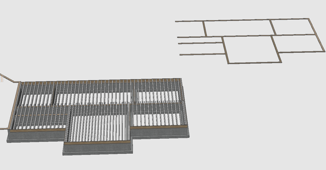

1. i have isolated my plan view, using hide layer command on multiple elements, to only show sill plate and temporarily copied over and will relocate on top of my tji's in 3d mode.
2. I select them and view them in 3d

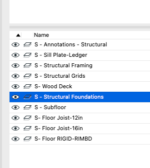

3. now all i want to do is turn back on the tji floor joists, sill plate & ledger board and a few others. i open the layer box and click the eye to turn on. after hitting OK nothing happens? why?

5. why do i now need to go back into model space and then try to get the elements i need to show in 3d? i'm sure ac probably does it differently, but this seems to be such a waste of time. i did some search for help but did not find it specific to what i was trying to accomplish. layer combinations seems to be how ac operates and i already have a book load of combinations. any suggestions and this is all i wanted to show at the end of the day...

@Zdenko wrote:
2. i select them and view in 3d
Because that essentially is a temporary isolation. Not by layer but by selection of elements.
You will see the tab's title to be "[3D / Selection]" instead of "[3D / Everything]" (or simliar wording, I'm not on an english version).
Hit "cmd + 3" again to see everything.
