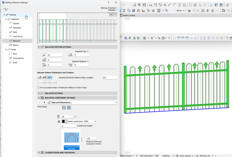

I would probably place the edge of the circle on the arched morph line and then tube it along the path.
That might be a little easier to control.
Once you have created this arched railing, you can save it as a custom baluster and use in in the railing tool.
The railing toll can be a bit fiddly in itself, but you can get some good results.
I actually scripted my balusters, but you can do a simple 'save as custom baluster'.
This image shows two different custom balusters combined into the one railing.
