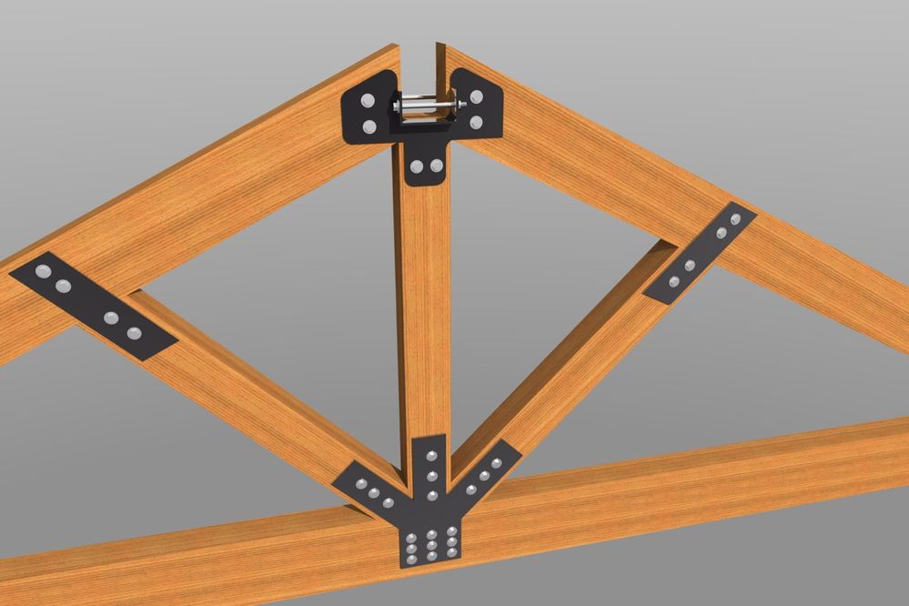

Hi KrisM. We use archicad exclusively for our timber frame designs. Very flexible. Haven't found anything we weren't able to model ….. SEO's and Morphs used a lot,especially for knee braces and arched beams.

MrC,
Thanks for the image. Nice. Are you just using the native Morph tool? Are you familiar with Objective? What about outputting a material list?
