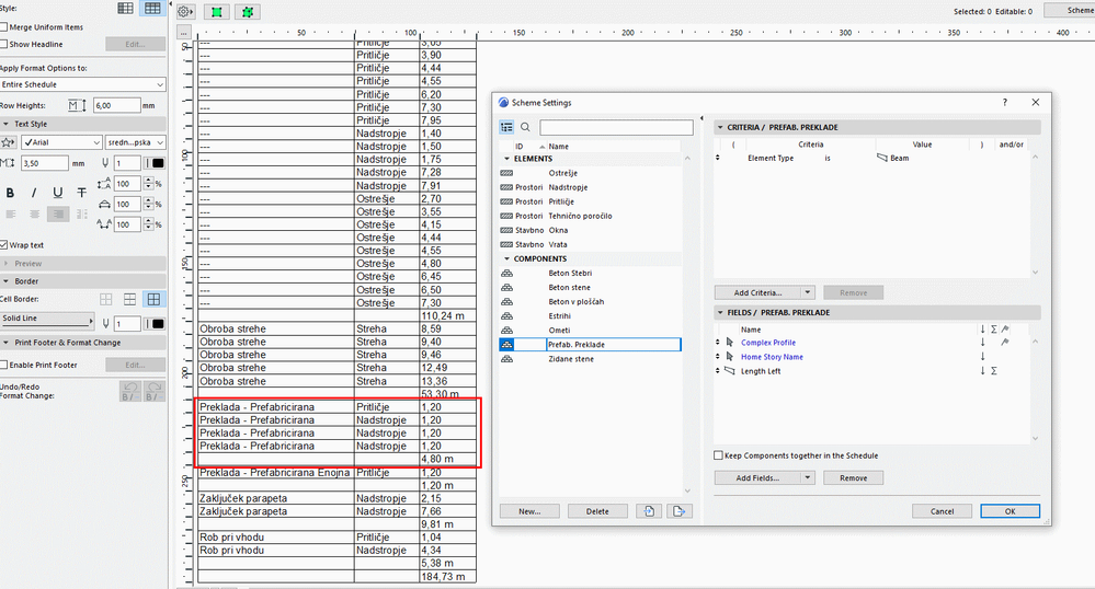

I have a weird problem scheduling beam lengths.
I wanted to schedule beam lengths and totals for specified Complex Profile(s).
When I create a chedule without Complex Profile filter criterio, everything works fine (see attachment wo criteria).
After I specify my Complex profile, each beam lists four times. Filtering out Beam Segment Element does not do anything here.
What am I missing?
Without Complex Profile FilterWithout Complex Profile Filter
With Complex Profile CriteriaWith Complex Profile Criteria

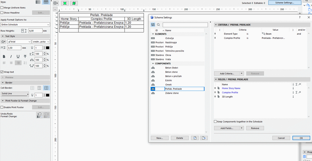

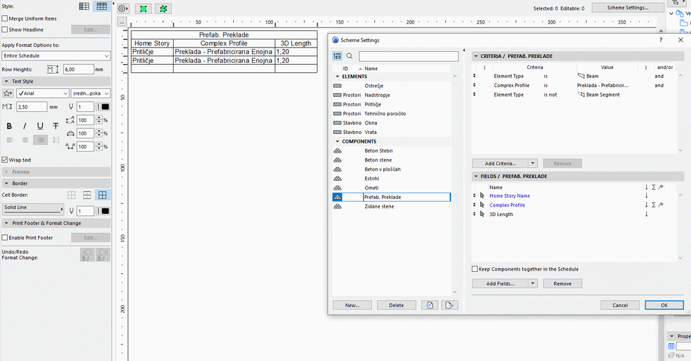

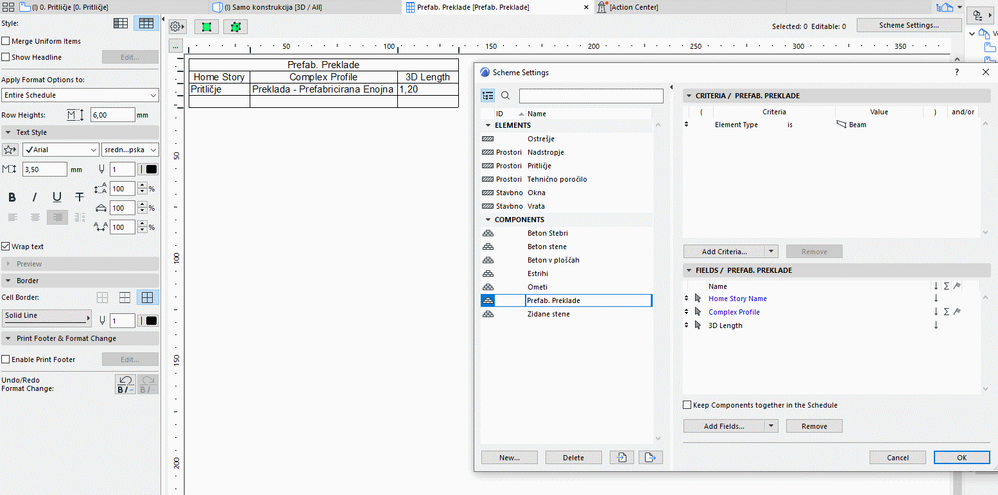

I've tried deleting all beams except one from entire project. From every layer and every renovation filter.
Schedule without Complex Profile criteria works fine (see second image). As soon as I add complex profile criteria, the beam gets listed twice (third image). Filtering out Beam Segment does not help either (fourth image).
