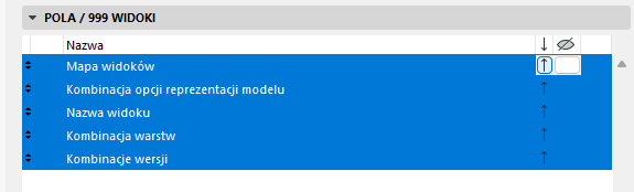

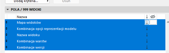

I have this annoying problem when setting up the Fields parameters in Schedules (also in Project Indexes). When you select multiple Fields you are able to change its settings together (for example sorting). Unfortunately even though during that operation everything seems to be working fine and all the settings change accordingly it seems that you are only changing the first Field options, because when you click OK and come back to the settings all the other Fields settings remain unchanged.
That seems like a bug to me - perhaps not the most urgent one, but annoying nevertheless.
Here are the screens of what I am trying to do in one go

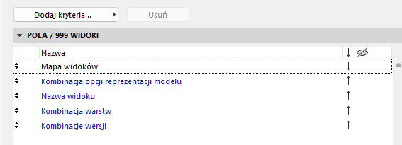

And here is the outcome when I accept and come back to the Settings (only the first Field updates)
