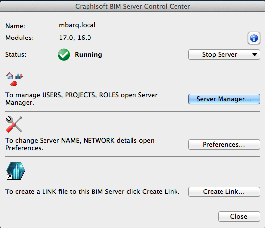

You would do a save-as (pln and/or pla) from the server and after verifying that the new files are correct then you would open "Bim Server Control Center" in the computer that is hosting the BimServer and delete the TW file there.
