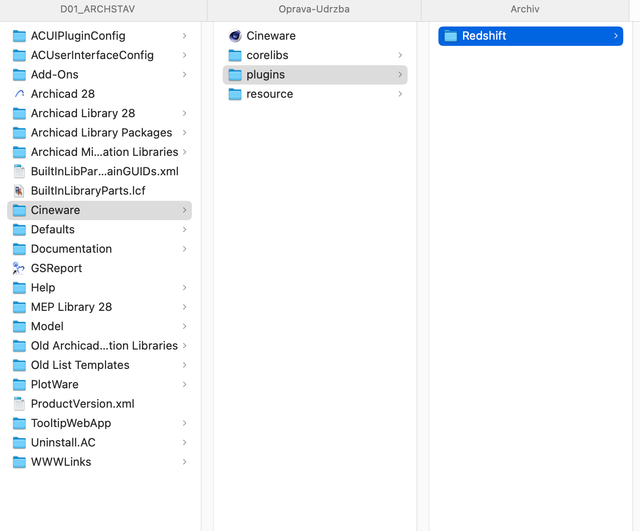

Try deleting the folder plugins from the Cineware folder.
this will of course lead to redshift not working, but cineware should be OK

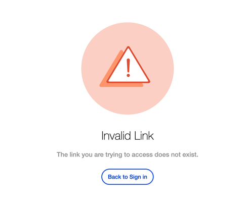

The link does not work for me, I get the message:
"Invalid Link
The link you are trying to access does not exist."

Hi all,
if you still have problems with cineware, please read this article from Graphisoft about know issues in macOS 15 where this problem is adressed including a new link for download.
