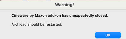

I just downloaded and installed ArchiCAD 28 and I get the same message regarding Cineware rendering engine quitting that I got with the 28 Technology preview:
Operating system used: Mac Intel-based

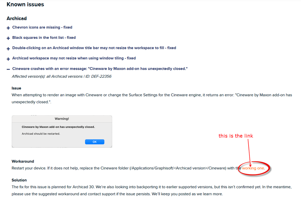

Can you please tell me where the new link for the download of the Cineware folder is?
Steve Pribyl
MAC OS Sequoia 15.5
ArchiCAD 28
In the article that Karel linked to ...
But I will add it here to save finding it.
https://graphisoft.sharefile.com/share/view/s0047a28b64a742b8930f768c6faf2a98
