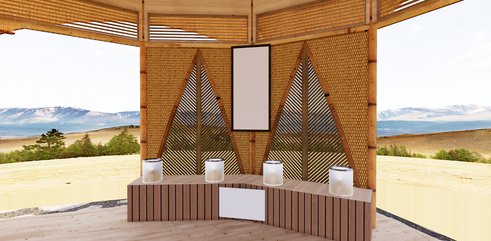

I would like to display a poster image in my Archicad model so that it is clearly visible in Enscape. At the moment, I am using the Picture object, but the image does not appear in the Enscape render.
I also tried applying the poster as a texture to a surface, but it is very difficult to align the image accurately, especially when I need to position it precisely within a frame.
Is there another method to display a poster or image that will be visible in Enscape while making it easier to position and align? What is the recommended workflow for this?
