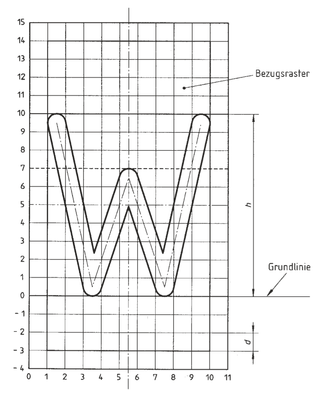

I think there are some misconceptions here.
The system as-is is already how it should be. The reason is simple: Archicad is not a desktop publishing nor a word processing program.
It might be worth to look at the history here, too. And historically type on plans has always been laid out based on their majuscule height. So much so that this is regulated in local norms, like the DIN EN ISO 3098-5 (or in this case so local its adopted internationally....).
This is of course the correct (and only) way to handle fonts (on plans). This ensures that two wildy different fonts, being on the same baseline, will still end up taking the same amount of space vertically.
So tl;dr: Archicad does it right and its behavior should not be changed.
