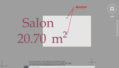

When i export a plan to autocad, all labels that uses GDL are not exported correctly , the text alignement is wrong,

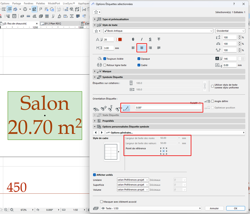

Here is the Zone  label , and it's settings
In autocad, it looks like that :

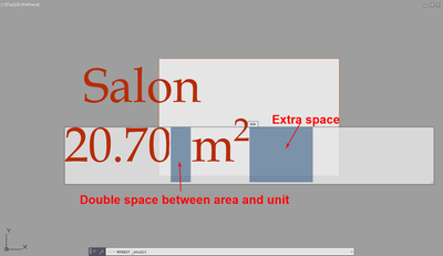

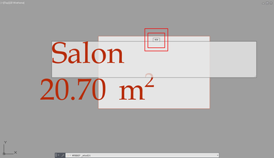

When i open the block , the text anchor points are in the middle , where they should be, and the text alignement parameter is set correctly to " Center" :

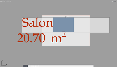

i noticed there is some extra "space caracters in the text field , :
When i delete that extra spaces, it looks correct,

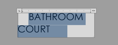

Notepad does not interperate it as a simple word space, but a word space and a forward slash...
BALCONY/ / / / / / / / / /
And it is only the last line...
